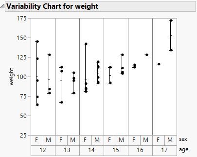

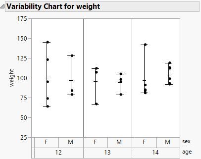

I just verified that dragging with the Hand / Grabber tool inside the X axis in fact works the same as for a continuous scale.
I wish I could show you how to do it. It is very simple to do but words might not convey the idea clearly for you.
Here is a picture before dragging the X axis:
Here is a picture after dragging in the X axis.
Maybe the change is not what you are looking for.
