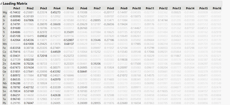

PCA - create loading matrix for each sample, instead of for each variable
Is there a way to view a loading matrix for each sample, showing the variation of each element? I envision a different table for each principal component.
The picture is an example of the table I need. The PCA was run for all of the elements in the table, but for 17 samples.
Thank you!!
(I am using the most recent version of JMPpro)

I think there is some confusion here: loadings would not change for each sample, they are the same for the entire table.  I think you might be looking for the score contributions, and you can see those using the MDMCC platform.  After launching the platform using scores saved from PLS, look for Monitor the Process > Score Plot, and then hover over a point in the scatterplot, or look at the contributions heat map.  Here is an example:
(view in My Videos)

That is what I am looking for, thank you very much!
