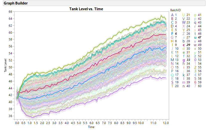

Attached is a subset of the data table Fermentation Process.jmp  If you split your Y columns by time (I am assuming you have the same time values), you can create the data table you describe.
Data Table( "Subset of Fermentation Process" ) <<
Split(
	Split By( :Time ),
	Split( :Ethanol, :Temp, :Molasses Feed, :NH3 Feed, :Air, :Tank Level, :pH ),
	Group( :BatchID ),
	Remaining Columns( Drop All ),
	Sort by Column Property
However, I am a firm believer of visual analytics and recommend it as the first analysis if your data set is not too large, prior to other modeling.
So prior to your PCA, I suggeest you plot each of your 20 variables by time using ID as an Overlay and Color variable in GraphBuilder to get some intuition of the time patterns and the consistency of the reactors. If you had JMP PRO FDE, it creates these plots in addition to methods that can scale and filter and align your data (time warping) which is terrific.  However, the visual analysis can potentially lead to more intuitive discriminating variables than eigenvectors. Consider the NH3 Feed vs.Time plot below. BatchID 6, 29, 33 and 47 have different temporal patterns, especially  before time 1.5 and after time 7.  A metric of start stability and end stability might be better predictors for quality metrics, andoften are more easily explainable to others not versed in PCA.
Just a few suggestions. Good luck!
