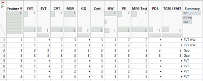

Here is other solution using matrices (could be turned into formula also):

col_names = Remove(dt << Get Column Names("String"), 1); //drop feature
all_ones = dt[0, 2::N Cols(dt)] == 1; //print this
dt << New Column("Summary", Character, << Set Each Value(
	teams = Loc(all_ones[Row(), 0]);
	If(N Items(teams) > 0,
		Concat Items(col_names[teams], " ")
	, "Gap"
Some explanation:
col_names = Remove(dt << Get Column Names("String"), 1); get team names
all_ones = dt[0, 2::N Cols(dt)] == 1;Get values in datatable to matrix. If cell value is 1 set it as 1, if it is missing leave as missing and other values will become 0
teams = Loc(all_ones[Row(), 0]) For current Row() get indices for columns which have 1
If(N Items(teams) > 0, Concat Items(col_names[teams], " ") , "Gap") Use col_teams[teams] to get list of teams which have 1, if teams count is 0 set as "Gap"
-Jarmo
