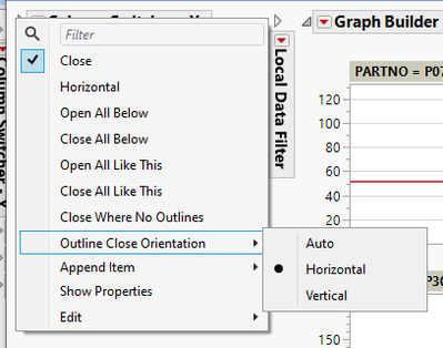

I've set their orientation to horizontal by right clicking on the maximize/minimize arrow and selecting this for each one:

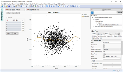

However, the script for this customization is not retained when I save the chart script for later use.  I see that there is this option in the scripting index:
but not sure how to apply it to just the column switchers (don't want it applied to the local data filter).  Thanks for any suggestions!

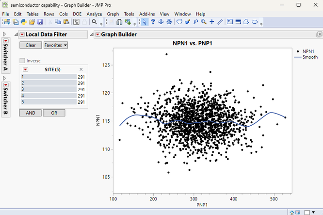

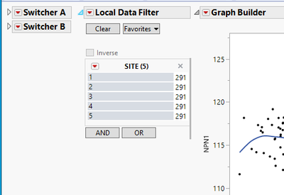

Thanks for the quick response!  I tired out your supplied script and it doesn't appear to get me where I wanted to go so let me show you how I modified the chart your script produced.  I'd like to have the chart open like this vs the default vertical orientation:

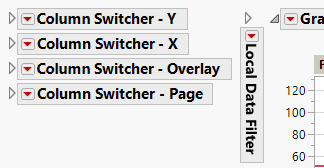

Which I changed by the method shown in my first post on right clicking this guy
and changing the close orientation.  However, this is not recorded in the script so if I hit redo or save the script out and rerun it later I will get the vertical alignment again and have to manually change it.
Hope this makes the ask clearer!
