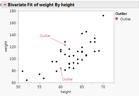

The easiest way would be to just create a new "outlier" column and mark the rows that are outliers.  You can then make that column a "label" column.  Once you have another column you can use it to color or use different marker styles (like x vs dot).  Since it's a label column you can highlight the points and show the row label.

Labelling outliers and finding outliers are two completely different questions.  There are lots of statitistical methods to determine outliers (Pierce, Grubbs, 3 sigma, box and whisker plots, ect)  all of which vary and disagree.  You can use the Analyze > Screening > Explore Outliers tool for this.
