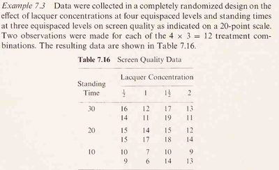

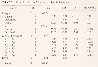

Book <Fundamental concepts in the design of experiments, C. Hicks 1982>
Page 156,
shows the following figure.
Raw data are

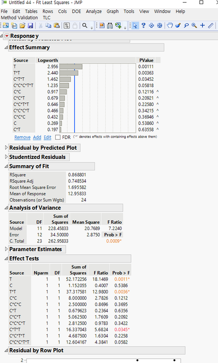

I had tried to create the SAME results as above in JMP, failed.
JMP's result is surely wrong since Sum of the SS does not equal to the Model SS. (they should be same.)

Textbooks will often present results that you can match with by-hand calculations. In this case, the results in the book are using what are called Type I Sums of Squares. These sums of squares are additive and easy to calculate by hand. However, the model results will depend on the order that the terms are listed in the model. What this means is that the model Y=intercept + B1*C + B2*T + B12*C*T will be different than the model Y=intercept + B2*T + B1*C + B12*C*T. Since the order that you specify your model can provide different results, Type I Sums of Squares are not often used. This is the root of your issue. Your JMP model was not specified in the same order as the book model. But there is more.
By default, JMP uses what are called Type III Sums of Squares. Type III Sums of Squares calculate the sums of squares for each model term as if it were the last term entered into the model. That means that you will get the same sums of squares and statistical test results regardless of the order that you enter the terms. But, this also means that the sums of squares will no longer be additive. This is why your JMP results do not add up as you would have expected.

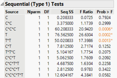

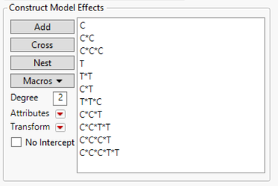

So how do you get your results to match? First, specify the same model order as the book. That means your Fit Model dialog should look like this:

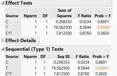

When you run this model, the sums of squares still will not match. However, if you go to the red triangle at the top of the model results and select Estimates > Sequential Tests you will get this report:
These results match the book results.

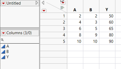

I should be more precise on my wording. You asked what situations have Y=A+B is not the same as Y=B+A. Remember, we are talking about sums of squares which leads to the statistical testing. So your book example already shows this situation. However, here is a simpler example that I just made.

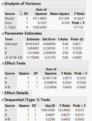

I fit the model Y=A+B+A*B and  Y=B+A+A*B. Here are the results for Y=A+B+A*B:
and Y=B+A+A*B
Although the parameter estimates are the same, the statistical testing results are NOT the same when using the Type 1 SS.
Also, remember that statistical models are ESTIMATING the parameter estimates. They are NOT known exact quantities. There is uncertainty in the parameters. But this issue of the statistical testing being order dependent is why Type I Sums of Squares are not often used. People dislike the fact that the order of the model terms can lead to different statistical conclusions and different interpretations of what we think the correct model is. It sounds like you are starting to see why the default in JMP is to use the Type III sums of squares because the order of the model does not matter then.
