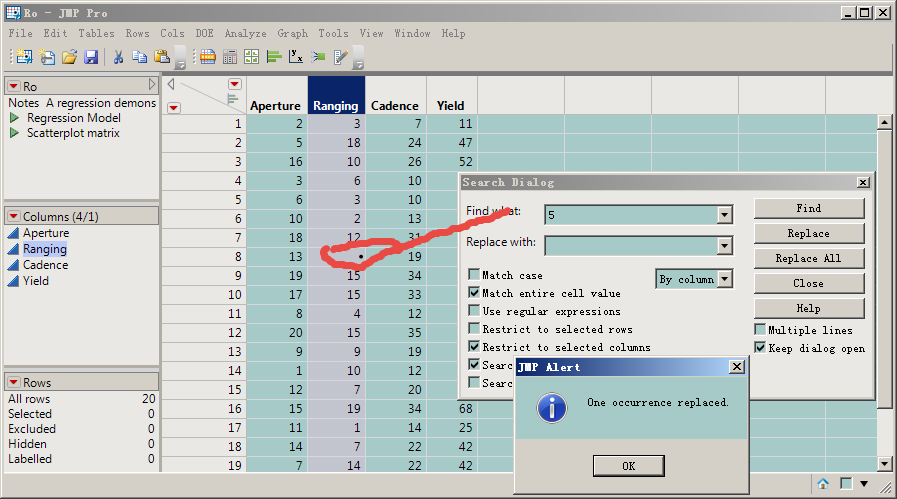

Re: Or how to implement this simple substitution with JSL?
How do you use JSL to perform the replacement operation to achieve this manual effect?
Replace column 2, "5" with null in a perfectly matched fashion, and "15" or "25" in this column are unaffected.
Thanks!
Numeric data should not pose a problem. See this example:
Names Default to Here( 1 );
dt = New Table( "Substitution",
	New Column( "Old Data", Numeric, Continuous ),
	New Column( "New Data", Numeric, Continuous )
:Old Data << Set Values( J( 50, 1, Random Integer( 3, 18 ) ) );
Wait( 2 );
For Each Row(
	:New Data = Substitute( :Old Data, 5, . );
Good way, thank you!
