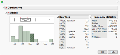

Here is one way to do this.  Just put the distribution into a modal window.
Names Default To Here( 1 );
dt =
// Open Data Table: Big Class.jmp
// → Data Table( "Big Class" )
Open( "$SAMPLE_DATA/Big Class.jmp" );
new window("",modal,
Distribution(
	Stack( 1 ),
	Continuous Distribution(
		Column( As Column( "weight" ) ),
		Horizontal Layout( 1 ),
		Vertical( 0 ),
No code past the window execution will be run until the OK button is pressed.
Jim
