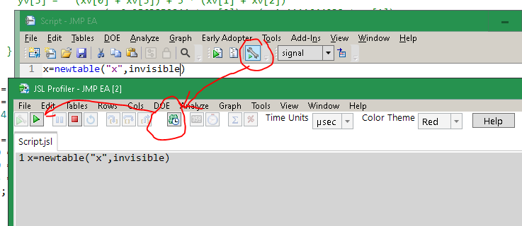

Adding to @Jed_Campbell's reply, you can also use the profiling feature in the JMP Debugger to determine where the bottlenecks are.

Craige_Hales
Re: Optimize Memory working with many data
If you are running out of memory, watch out for private data tables that you forgot to close. (try making them invisible rather than private to make sure you've closed them. Invisible still shows up in the home window.)
If JMP runs slower and slower
  • if you have an old-school desktop with a disk light, keep an eye on it to see if stays on a lot. You might be creating matrices that are really big. J(10000) makes a 2D (not 1D) matrix.
  • if you are building a string or matrix by concatenating to the end, that gets really slow as the string or matrix gets larger. Pre-allocate the matrix to the right size, or use a list of string parts followed by concatitems() when done.
Do use the JSL debugger's profiler as @Mark_Bailey  suggests.
Wrench, Clock, GoWrench, Clock, Go
If you get lucky, there will be an obvious hotspot that might match something above.
