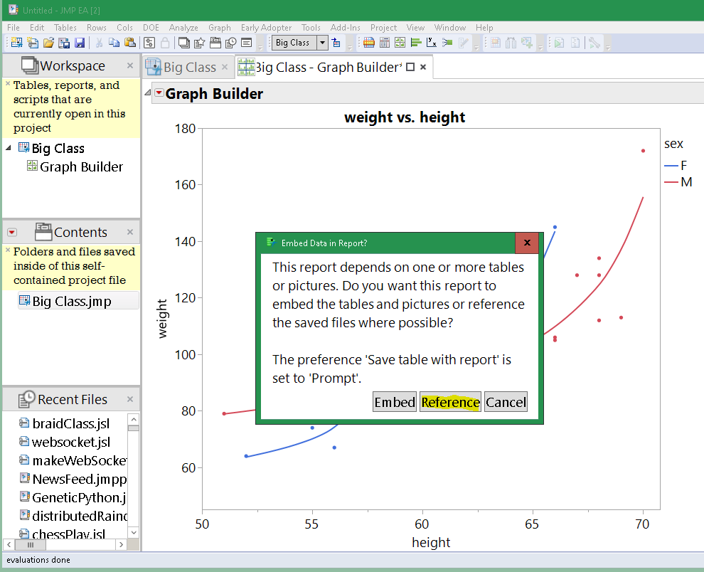

Craige_Hales
Re: Opening a graph in a project also opens up a new datatable
Do it this way:
Choose the Reference option.Choose the Reference option.
You are saving a JRP (report) file into the project. The JRP is just the script to reproduce the report with some sort of pointer to the data that was used. If you pick Embed, the data is embedded into the JRP, making a static copy that belongs to the JRP. If you pick Reference, the JRP will point to where the data lives when the JRP is created (the project's copy.)
Craige
Thank you, this is exactly what I wanted! (:
I never saw the "Embed Data in Report?" prompt because under Preferences>Report the "Save table with report" was set to "Embed" by default. I changed it to "Prompt" and now when I use the "Reference" option everything works the way I like it.
