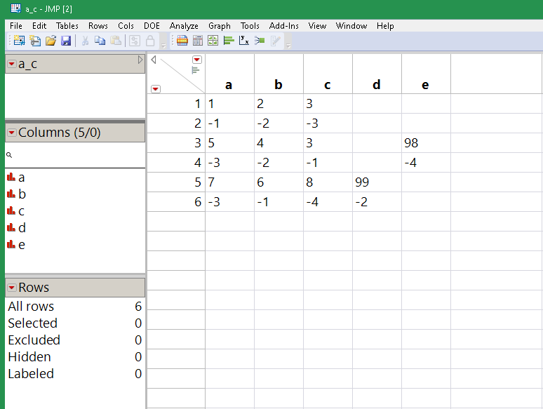

Craige_Hales
Re: Open multiple Files
Something like this might work.
// use MFI to stack a mixed bag of tables...
// assumes "text" and "file name" are not columns in the data AND assumes
// no commas in the data values. Not sure how you would work around that.
dir = "$temp/testfiles/"; // make sample files here
Delete Directory( dir );
Create Directory( dir );
Save Text File( dir || "a.csv", "a,b,c\!n1,2,3\!n-1,-2,-3" );
Save Text File( dir || "b.csv", "junk\!nc,b,a,e\!n3,4,5,98\!n-1,-2,-3,-4" );
Save Text File( dir || "c.csv", "junk\!njunk\!nb,d,a,c\!n6,99,7,8\!n-1,-2,-3,-4" );
dtList = Multiple File Import(
    <<Set Folder( dir ),
    <<Set Add File Name Column( 1 ),
    <<Set Import Mode( "Row Per Line" ),
    <<Set Stack Mode( "Stack Similar" )
) << Import Data;
dt = dtList[1];
// clean up "junk". It might not be this simple for your data...
dt << selectwhere( Contains( text, "junk" ) );
dt << deleterows;
// hunt for unique column names
headerrows = dt << getrowswhere( Row() == 1 | FileName[Row()] != FileName[Row() - 1] );
uniquecols = Associative Array( Words( Concat Items( Transform Each( {header}, dt[headerrows, {text}], header[1] ), "," ), "," ) ) << getkeys;
// add the unique column names, character data for now...
For Each( {cname}, uniquecols, dt << New Column( cname, character ) );
// transfer data from text to unique cols.
headerrows |/= N Rows( dt ) + 1; // append sentinel
For( iheader = 1, iheader < N Rows( headerrows ), iheader += 1,
    cols = Words( dt:text[headerrows[iheader]], "," );
    startrow = headerrows[iheader] + 1;
    stoprow = headerrows[iheader + 1] - 1;
    For( irow = startrow, irow <= stoprow, irow += 1,
        dt[irow, cols] = Words( dt:text[irow], "," )
// remove the headers and left over bits
dt << selectrows( headerrows[1 :: N Rows( headerrows ) - 1] );
dt << deleterows;
dt << delete columns( {text, file name} );
dt << delete scripts( "files" );
dt << delete scripts( "source" );
cleaned upcleaned up
Now you'll have to decide which columns are numeric...
Craige
dt << deleterows;

Thanks @Craige_Hales - many really good ideas to copy!
Unfortunately, the
is quite slow ...
here an example - on my system it takes one second to load the data and 10 seconds to convert the data ...
View more...

hogi
Level XIII
How about this:
  • use the ultra-fast MFI-Import (with csv-option)
  • separate the input files via Subset(private)
  • postprocess the data to get meaningful column names [here just a moveup]
  • concatenate the files
// then splits the data via Subset(private)
// ... some postprocessing ...
// and then concatenate the files
open(dir);
dt0 = Open( "$SAMPLE_DATA/Big Class.jmp" );
Foreach ({i,idx},1::300,
dt0 << Save( dir || char(i)||".csv" ));
t1=HPtime();
dtList = (Multiple File Import(
	<<Set Import Mode( "CSVData" ),
	<<Set Stack Mode( "Stack Similar" ),
	<<Set CSV Has Headers( 0 ),
	<<Set CSV Allow Numeric( 0 ),
	<<Set CSV First Data Line( 1 ),
	<<Set CSV EOF Comma( 1 )
) << Import Data)[1];
t2 = HPtime();
myDTs =dtList << Subset(By( :File Name ), Private);
Close(dtList,noSave);
myDTs  << Move up;
t3 = HPtime();
myDTs[1] << Concatenate( myDTs[2::N Items(myDTs)], Append to first table ); // geht auch, wenn n=1
finalVersion = myDTs[1]  << Subset( Link To Original Data Table( 0 ), Output Table( Word(-2,dir,"\/") ));
For Each( {dt}, myDTs, Close( dt, noSave ) );
t4 = HPtime();
show((t2-t1)/1000000,(t3-t2)/1000000,(t4-t3)/1000000)
