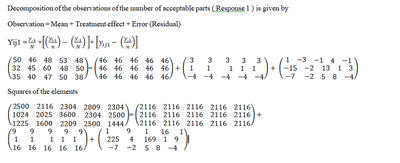

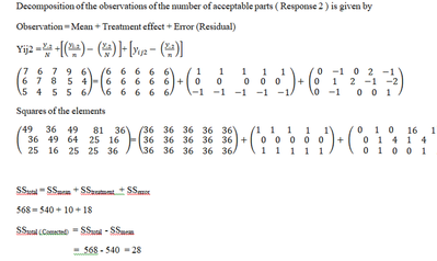

I am trying to replicate this example in JMP. I am also attaching the dataset. Can you please guide how to perform this in JMP?
statslearner_1-1747757281552.pngstatslearner_2-1747757294687.pngstatslearner_3-1747757301965.pngstatslearner_4-1747757308552.png

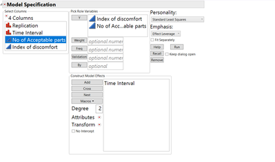

I think more context to the data structure, the goal and the source for this (if it is an academic article that is available). I've had a look and you want to use the Fit Model platform to fit the model as shown below:
The model reports will show you the parameter estimates matching those shown in the document you've attached
