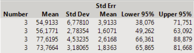

Assuming that you used the Fit Y by X platform, would it be posible for you to display the means and standard deviation table?

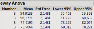

In attachement there are both the mean and standard deviation table, as well as the means for oneway anova table.

The analysis of variance relies on a pooled within-cell error term (the mean square error of the model) as the estimate of the population variance (which is one reason why the assumption of homogeneity of variance is important for an ANOVA). The implication of this is that confidence intervals formed around individual means use the same estimate of the population variance to calculate the standard error, so if you have the same number of individuals in each group you will then have confidence intervals of the same width. I hope this helps!

The ANOVA tests the null hypothesis that all the means are equal versus the alternative hypothesis that they are not all equal. The method assumes that the within group variance is the same and pools the estimate of this variance. This assumption in turn leads to width of the confidence intervals and the height of the mean diamonds (graphic for CI) to be the same.
The Unequal Variance command will test this assumption. If the variances are significantly different, then you should not use the ANOVA result or the mean diamonds to decide about the hypotheses. The same command also performs the Welsh version of the procedure that adjusts for the difference in the variances.
