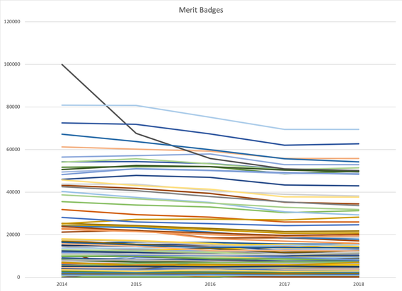

This seems like it should be pretty easy, but it's not, and it's something I often run into and wonder if there's an easier way.
Here's an example dataset from https://blog.scoutingmagazine.org/2019/02/11/2018-merit-badge-rankings-a-deep-dive-into-the-official...
I would like to build a single plot with a line for each merit badge.  There will be a bunch on top of each other, but suppose I'm interested in the standouts, the lines at the top and bottom.
I went through the hassle of making it in Excel to show what I'm trying to do:
Is there a good way to do this with JMP?

I've managed to make this happen.
First, I simply copied and pasted the table from the article into a JMP table using Edit > Paste with Column Names.
Second, I had to change a couple of columns to be Numeric, Continuous because they had some character data within it.
I then stacked the data table and used Graphbuilder to create the graph.
I put it all in a script (except the changing the column attributes - though I could have scripted that too). See attached.

Wow, okay -- that's fantastic!
The key was making the badges an overlay, which never entered my mind.  I thought I'd have to put intermediate lines between the sections with "." in all the columns to make the lines break.  What is overlay supposed to be anyway?  (I'll just read the manual, but it's never made a lot of sense to me.)
