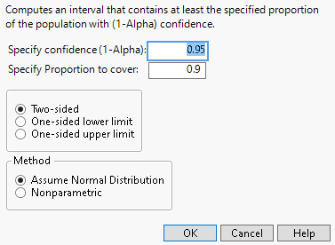

I have a data set and I determined the one-sided upper tolerance interval using JMP, using a 95/95%. For work, I need to do it in excel, does anyone have the formula for the one-sided tolerance interval, so I do it in excel, as new data comes in. I was able to determine the two-sided tolerance interval, but not one-sided.

Having one question, seen the old jump have quantile probability pop-up window feature to type probability to get the quantile number. Not seeing it in JUMP 17 any more, can I ask if tolerance interval is the same replacing it?
Hoping to find the matching quantile based on the sigma value provided and corresponding probability.
i.e. 6 sigma (0.999999999), 4.8 sigma (0.999999)
Selecting one-sided, specifying confidence 0.95 and proportion to cover 0.999999999, can I get the corresponding quantile value?
