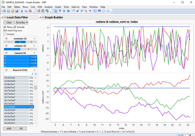

Where to begin? I originally asked for help (see link below) on how to make a blanket 360 degree flip based on a spec value however looking into a bit more thoroughly that won't work because the phase is wrapped. There is a process to unwrap the phase to a continuous form.
The process is as follows: (using Radian Values)
1) Start with the second sample from the left in the wrapped phase signal.
2) Calculate the difference between the current sample and its directly adjacent left-hand neighbour.
3) If the difference between the two is larger than +π, then subtract 2π from this sample and also from all the samples to the right of it.
4) If the difference between the two is smaller than -π, then add 2π to this sample and also to all the samples to the right of it.
5) Have all the samples been processed? If No then go back to step 2. If Yes then stop
I am looking for some assistance in performing this operation and have attached a sample data table for reference.
In this data table I need to unwrap by :RowCol, :channel, :teststate and refstate.
Thanks in advance

Any idea what the correct result would look like? Something similar to this:
Wrapped phase:
Should this be changed?
Running this script will be fairly slow, but most likely it can be optimized to be faster (it also has an problem if last value is in wrong phase):

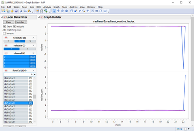

Issue with last sample:
Wrapped phase:

This is great work @jthi.
(picture 1): I would think that as long as the curve holds the same shape of the parts / channel that didn't have the wrapped phase, it is correct. I will verify with the test folks.

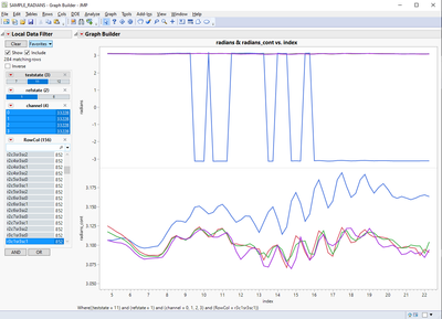

(picture 2): I think that blue line (channel 0) is dead but the other 3 channels had a tremendous number of wrapped phases and your script worked it out.
(picture 3): I can live with that for now as we are screening at two (2) middle indices and not the last.
