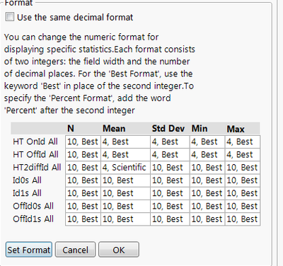

Hi all,
I am trying to change the numeric formats in the tabulate platform, and I can't get it to do scientific notation or engineering SI.  Is it not possible?  I would also really like to reduce the number of significant digits.  I am able to change the number of significant digits for some columns, but in others where the value is 10^-7 (or something like that), I can't.  For example, in the HT2diffId All column under mean, I just have number signs even though I changed the format to scientific.  What am I missing?
