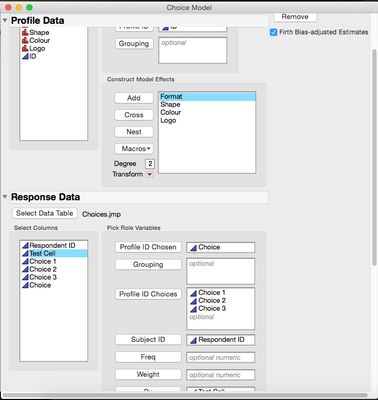

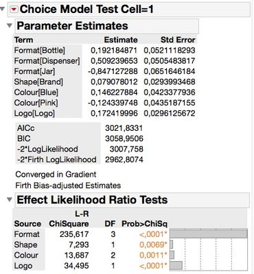

I have followed the help for running a choice model on the attached Profile and Choice Data. I can't understand why the Tube, Generic, and None parameters don't show in the results (see attached JPG). There are four attributes, Format (4 levels), Shape (2 levels), Colour (3 levels) and Logo (2 levels). There are three profile ID choices, and the test is weighted by 'Test Cell' which seperates 4 different groups of people.

The last level of each attribute is not shown in the parameter estimates table because it is not independent of the others. All of the parameter estimates for a particular attribute will sum to zero, so the last level will be the additive inverse of the sum of the other levels. You can choose Effect Marginals from the red triangle menu and you will see the values for all levels of each attribute.

@susan_walsh1THANK YOU! I did not click enough of the buttons to see that show up in JMP and have been trying to run an analysis in R instead for weeks. I am so grateful!
