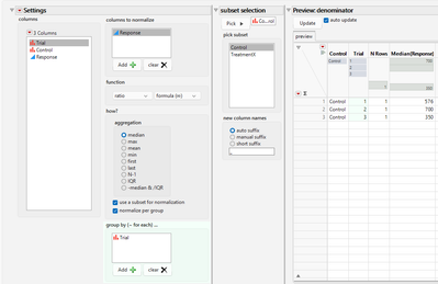

If it's just about calculating the ratio (or difference) per trial , you  can use the Normalization AddIn from https://marketplace.jmp.com/appdetails/Normalization+GUI
e.g. with the settings:
- column to normalize : Response
- function: ratio or difference
- grouping: by trial
- subset: Control
[The default aggregation is median, which works well even with just a single control and is much faster than the other modes.]
