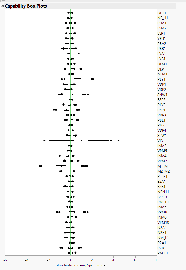

The chart you want is available in the Process Capability platform
     Analyze=>Quality and Process=>Process Capability

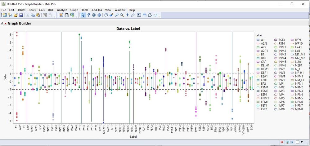

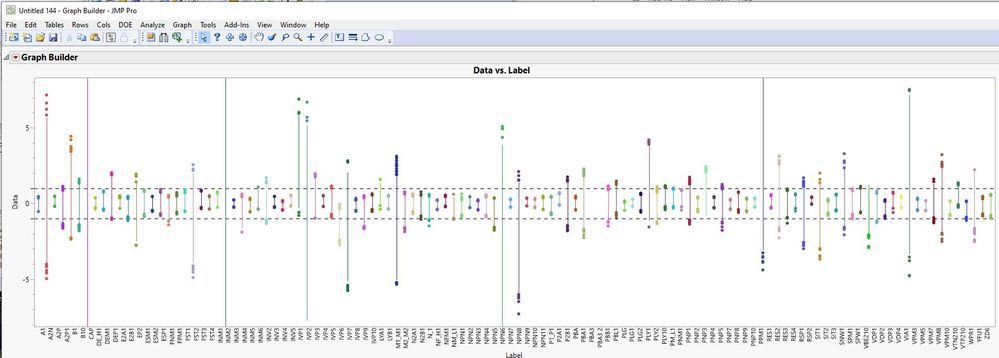

The Process Capability platform does not have such an option.  However, with some manipulation, I was able to get the Graph Builder platform to create the below chart

txnelson
Re: Normalization of multiple graphs in one chart
Below is the script that produces the output.  Everything in the script was actually first created by running JMP interactively and then having JMP kick out the JSL that produced the output step.  The only one step that was not produced this way, was the step that normalized the data.  That is a piece of JSL that was written from scratch.
