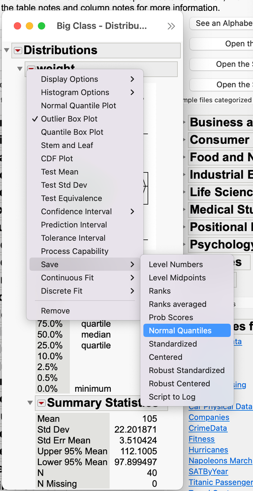

You can also do normal quantile transformation using the Distribution platform.  For large tables this can be faster than using column formulas.
