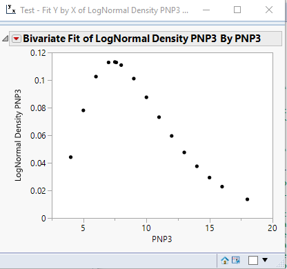

THack501
Level I
Re: Normal Distributions and Transformations
Perhaps it is my dataset then? In short, I was picking a value from my data set and pulling out the lognormal transformed value for testing/validating the code. My data set is below. A value of 7 corresponds to a transformed value of 0.112832236739791, therefore I should be able to use the transformed value as the target in the code and the script should spit out 7. Correct?

After running the code, here is the log output
MatchValue = 7;
TargetValue = 0.112832236739791;
Gettrans("PNP3", "LogNormal Density PNP3", 0.112832236739791, myFormula) = 18;
The output of the Gettrans function should be 7. The value of 18 that the code is outputting corresponds to a transformed value of 0.0135701784925184.
txnelson
The script will not work for the Denisity Transformation.  The function produces multiple values for the same density value and the code can not handle that.  See graph below
Jim
