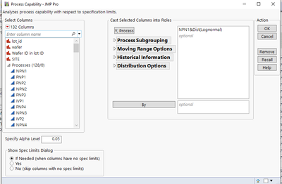

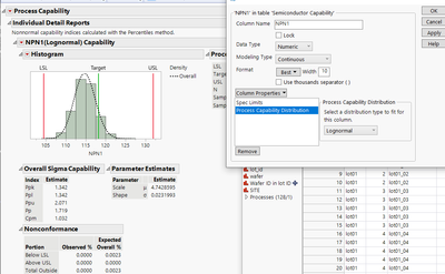

Process capability seems to manage just fine with the property defined in Process Capability Distribution property
It will get added when you add the column to the platform selections so you might have to take this into account when scripting
