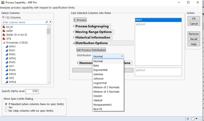

Process capability seems to manage just fine with the property defined in Process Capability Distribution property
It will get added when you add the column to the platform selections so you might have to take this into account when scripting
Column which has no distributions defined
For Process Screening I'm not sure if you can define the distribution and it seems to have it's own column properties
