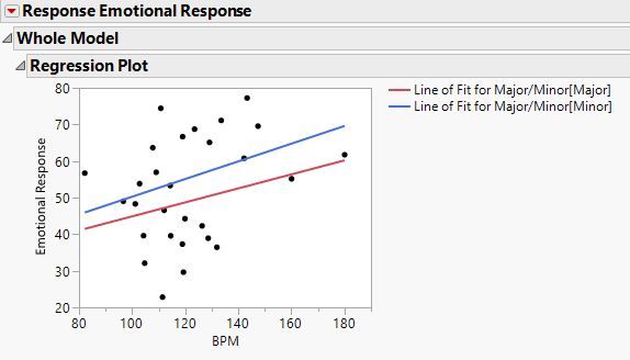

2) It works with Fit Y by X. However, I want to use Fit Model since I have another variable which is the tempo of the music clips (continous variable). I am looking at the main effects and the interaction effects. When I look at the main effect for the mode, the report only shows results for major and not for minor. Why is it so?

Concerning the second point, if you launch the "Fit model" platform with a Standard Least Square personality, you will have a regresssion graph showing for each category (Major/Minor) the regression line (see photo below/attached).
You can also have a look on how significant are main effects and interaction on the "Effect Summary" in order to take into account (or not) the interaction in your analysis. You can also use the Graph Builder in order to see emotional response in function of your inputs, and showing details about regression coefficient in order to help you.
Finally, if you think it may be good to have a look at several parameters in order to see differences in case of interaction, I would give a try to the "Variability / Attribute Gauge chart" in "Analyze", then "Quality and Process". You could be able to see if several parameter seems to influence the response in a particular way. You can do it directly, or create a "class" column (categorical) for your continuous input tempo in order to group similar tempo by categorical groups.

Re: Nominal variable in ANOVA report
I do not think that there is any implied or meaningful order to minor versus major so nominal seems the most reasonable choice for modeling type.
The Effect Tests reports the evidence for the entire model term. The Parameter Estimates to which you refer reports evidence for individual parameters. The coding of the categorical factor levels is such that they must sum to zero for the term. You have two levels for Mode so the parameter for the Minor level is the negative of the estimate for the Major level. You can click the red triangle at the top and select Expanded Estimates to see the estimates for all the levels at once.
