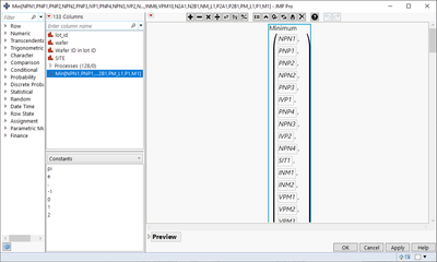

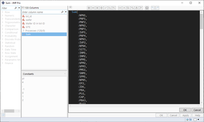

I would most likely do something like this to avoid scripting:
  1. Select all columns of interest
  2. Create quick formula using for example Combine/Min (everything is fine which fill wrap all columns inside single function, Min/Max came first to my mind)
  3. Open the newly created formula and change Minimum to Sum in formula editor
  4. Press OK, verify results and press Apply/OK

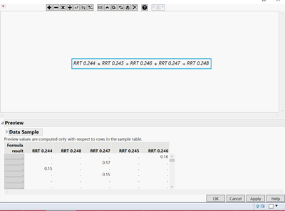

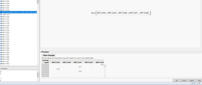

Here are a few screenshots of a similar formula which also isn't giving any result. Data sample shows the table it is drawing the data from.

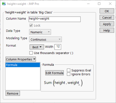

Sum() is able to handle missing values. Just change the + to , in the formula to separate different columns. Currently it is calculating "sum" twice. It should look something like this
-Jarmo
