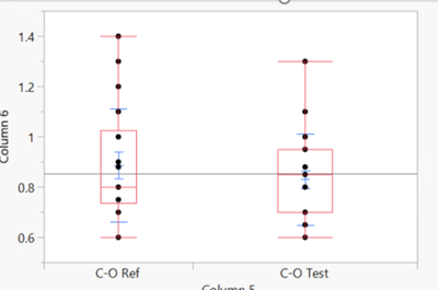

My question is: Is that ok or not OK if I do equivalence test several times to find the equivalent limit that has 2 p-values < 5%.
I have 2 groups data like below & I want to test if they are equal or different.

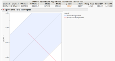

1st step I did a t-test & Pvalue> 5% mean I failed to reject H0  (Test= ref). Not really help much to define my next actions.
So I do an equivalence test with the equivalent limit of +/-0.1 as a practical range
But again the result is not really good. I just can conclude that my Test group is higher then REF 0.1 unit or lower.
Still not a useful enough result for next actions
So I increase several time until reach the equivalent limit 0.16 unit & have 2 P-value <5%
Which I can interpret result as 2 group is equal in 0.16 unit range.
Meaning that My TEST group can higher/ lower than REF +/- 0.16 unit. (or could be equal too)
So I can estimate the best case if this 0.16 unit higher or lower the current is OK for my next action.
Is my conclusion correct? & Is that possible for me to do that? or Am I P-hacking?

It's a good question. But p-hacking aside, I think that you are misinterpreting the equivalence test. These things are confusing, I know!
The low p-value in your last case is telling you that the 2 groups ARE practically equivalent. The confidence bounds around the estimated difference are within the practical range of +/- 0.16.
The help documentation for this test should be useful.
