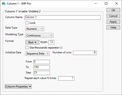

Easiest way to do this is to initialize new column with sequence data
you can then get the script from log if you have JMP16+ and enhanced log enabled (if you need it)

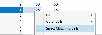

Edit: misread the question, you don't want to have 75 there. One option then is to select one 75, right click and select matching cells and delete those
(jmp is able to record this also)

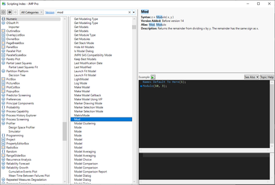

Scripting Index is very helpful if you need to know what the functions do, it does also provide examples you can run. It can be found from JMP's Help menu
Help button will open JMP Help page for that function Modulo(number, divisor)
