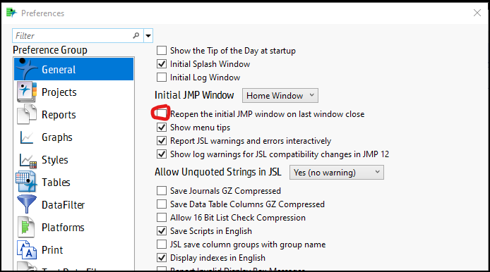

The thing I seem to have found that finally solved this problem for me, which bothered me for a long time, was to uncheck the 'Reopen the initial JMP window on last window close' box in the Preferences/General.
It doesn't seem like that should do it, but I believe it has fixed it.
wencun6
Level III
Re: New instance of JMP® is opened each time a new file is opened
This helped me as well

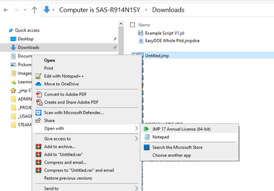

Hi Everyone,
Here is one more thing you can try which has helped me in the past (after first attempting to reset file associations and it not remedying the problem for me).
1. Using Windows File Explorer, Change the default program to open a .jmp file from JMP17 to Notepad.
2. Then open a few .jmp files in Notepad (by double-clicking the files in windows explorer).
3. After that, Change the file association back to JMP17.
Hope this helps!
