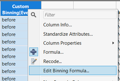

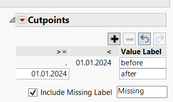

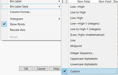

Via the GUI, you can use Custom Binning:
and use custom labels:
To adjust the settings, use
