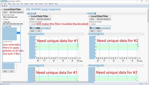

 ::edit:: Added a comment in the code and included a screenshot to help visualize.
Is it possible to do nested filter context boxes or to generate something that effectively does the same thing? Basically I want a set of parent filters that apply to all plots in a report. The reports within that plot need their own particular filters to limit the data they display.
I have an interactive report layed like this:
(1) An H List box divided into two columns.
    (A) The first column contains a set of filters that apply to anything in the second column.
    (B) The second column contains a tab box with multiple tabs for different "tool types."
         (i) Each tab contains an h list box with a column of variabiity charts for each "tool" of a given type. Each column needs its own filter to limit which "tool" it displays.
              (a) This filter is hard coded based on a list, but the VarCharts need to update based on the filters in (A).
What I am finding is that if I put a where() within the variability chart, it ignores the filters in (A). I then tried nesting filter context boxes, but this doesn't seem to work. The new filters show up, but only the parent-most filter actually does anything.
I attempted to create a stripped-down/anonymized version of my code, so there may be some typos:

Thanks Jim! Unless I'm misunderstanding/overlooking something, this is only filtering the second graph based on the first. How do I filter the second graph in addition to the first?
i.e. I want the second graph filtered based on the first, but in addition, I only want a subset of the data in the first filter.
Effectively what I want is to add "Where( :ToolID == pTools[j] );" to the Variability chart, but if I do this then it completely ignores the Data Filter Source Box (or in my case the local data filter). I actually spent a long time trying to figure out what I was doing wrong with the Data Filter Source Box only to realize it worked once I removed the above "where" line from the Variability Charts.

Can you apply different sub-filters to different plots with this method? It seems all plots will receive the same filters.
I need a single primary filter with a series of independent (invisible) sub-filters applied to different sets of plots. I've updated my original post with a commented-out "where" filter to better convey this.
