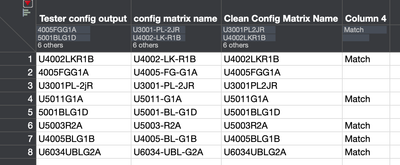

Below an example of 2 columns to be matched, I used a third column to remove the "-" with substitute(), and a 4th column to compare but the match is still weak on most cases.
New Table( "untitled 1",
	Add Rows( 8 ),
	New Column( "Tester config output",
		Character,
		"Nominal",
		Set Values(
			{"U4002LKR1B", "4005FGG1A", "U3001PL-2jR", "U5011G1A", "5001BLG1D",
			"U5003R2A", "U4005BLG1B", "U6034UBLG2A"}
		Set Display Width( 114 )
	New Column( "config matrix name",
		Character,
		"Nominal",
		Set Values(
			{"U4002-LK-R1B", "U4005-FG-G1A", "U3001-PL-2JR", "U5011-G1A",
			"U5001-BL-G1D", "U5003-R2A", "U4005-BL-G1B", "U6034-UBL-G2A"}
	New Column( "Clean Config Matrix Name",
		Character,
		"Nominal",
		Formula( Substitute( :config matrix name, "-", "" ) )
	New Column( "Column 4",
		Character,
		"Nominal",
		Formula( If( :Clean Config Matrix Name == :Tester config output, "Match" ) )

Voizingu
Level IV
Re: Need to join two tables based on non-identical strings (Use Regex?) in JSL
Hi Jarmo,
thanks a lot for your feedback,
I tried this piece of script on a larger dataset and it seems to be accurate enough, it matches >96% of the time.
I added "Replace Unmatched(1), Unmatched (value="NoMatch")" to the arguments of Choose Closest () to make sure it flags when there is no match.
Appreciate your help once again
