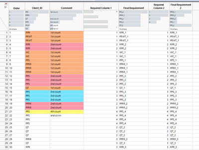

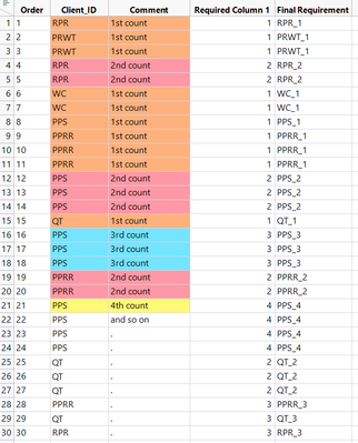

I want to create a column based on :Client_ID and how many times ( a number of sequence is counted as 1 count only, see the the :Comment column) it is appearing in the data set. My requirement is :Final Requirement  and would be happy to have :Required Column 1 as well. I can not re-arrange/sort the data.

Using associative array to store the value and then increase as needed should work here.
Formula for Required Column 1:
As Constant(
	aa = Associative Array(:Client_ID);
	aa = Associative Array(aa << get keys, Repeat(0, N Items(aa)));
	retval = 1;
If(:Client_ID != Lag(:Client_ID),
	aa[:Client_ID]++;
aa[:Client_ID];
And Final Requirement:
Eval Insert("^:Client_ID^_^:Required Column 2^");

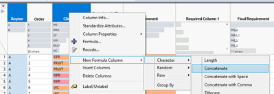

Easiest thing is most likely to create new column and then use that as grouping instead of :Client_ID (original formula)
Col Cumulative Sum(:"Concatenate[Region,Client_ID]"n != Lag(:"Concatenate[Region,Client_ID]"n), :"Concatenate[Region,Client_ID]"n)

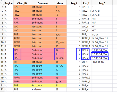

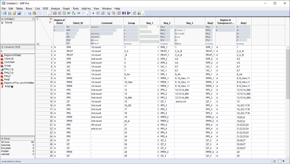

Hi All,
There is a further requirement - to add one more column :Req_3, where all the texts from :Group would be combined and stored. :Group text can be as long as 2 lines. Separator can be any thing.
The problem is - number of cells need to be combined is not fix, it depends upon the value in column :Req_1.
"Req_3" is required.
Any help, Thanks.

Using SQL query (especially GROUP_CONCAT) or JMP's different table operations (split, transpose, text to columns and combine columns, join back) might be easier than formula (and faster), but you could do it with a formula for example by using Loc() and indexing of different columns.
Edit: Added interactive method

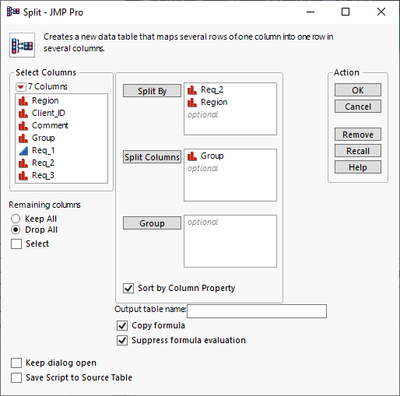

First split data:

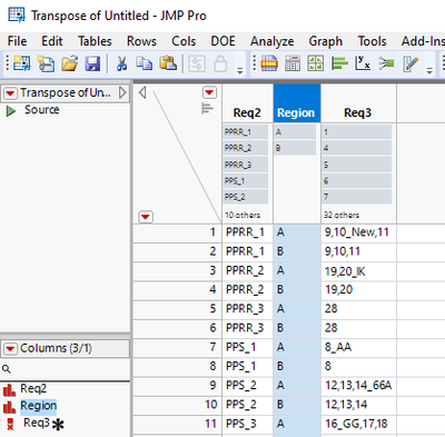

Next transpose the split data:

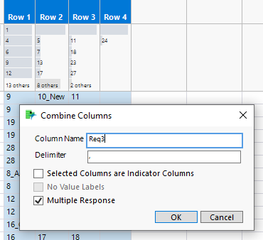

From transposed data, first use text to columns to separate Req2 and Region from each other
Then use combine columns to combine Row columns
Rename and remove unnecessary columns and you should end up with something like this

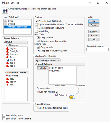

Join this with the original data2
Remove extra columns and you should have what you need.

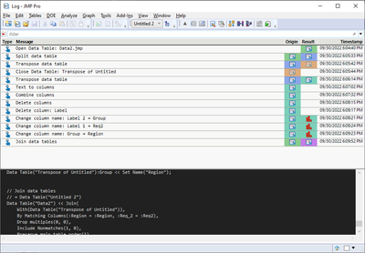

Enhanced Log might have script ready for you, but you might have to clean it up a bit
