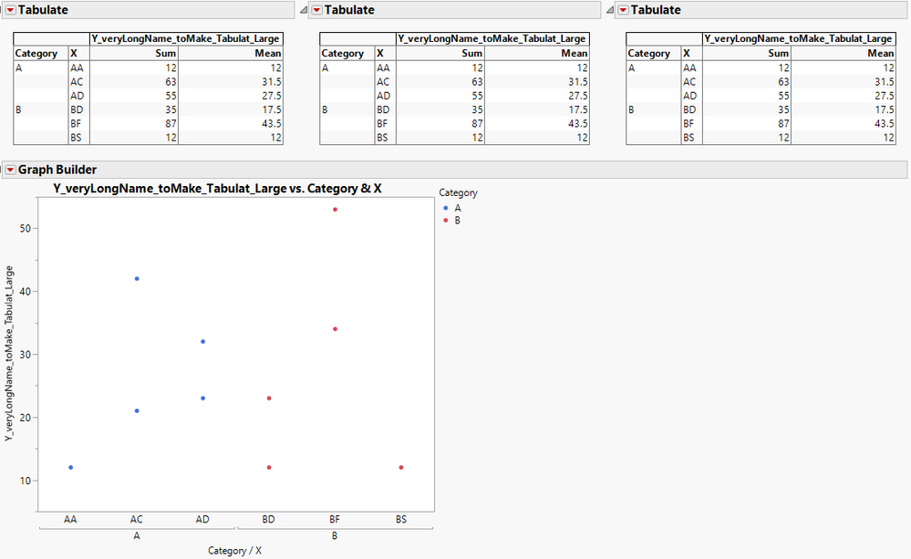

How to stretch GB to fill all available space?
Let's say I have a 3 column Line Up box with some display boxes, and then as a second row I have an Unlineup Box with a Graph Builder inside.
Example can be seen by running this script:
dt = New Table( "DEMO",
	Add Rows( 10 ),
	New Column( "Category",
		Character,
		"Nominal",
		Set Values( {"A", "A", "A", "A", "A", "B", "B", "B", "B", "B"} )
	New Column( "X",
		Character,
		"Nominal",
		Set Values( {"AA", "AD", "AC", "AD", "AC", "BD", "BF", "BF", "BD", "BS"} )
	New Column( "Y_veryLongName_toMake_Tabulat_Large",
		Numeric,
		"Continuous",
		Format( "Best", 12 ),
		Set Values( [12, 32, 42, 23, 21, 12, 34, 53, 23, 12] )
tab = dt << Tabulate(
	Show Control Panel( 0 ),
	Add Table(
		Column Table(
			Analysis Columns( :Y_veryLongName_toMake_Tabulat_Large ),
			Statistics( Sum, Mean )
		Row Table( Grouping Columns( :Category, :X ) )
gb = dt << Graph Builder(
	//Size( 528, 464 ),
	Variables(
		X( :Category ),
		X( :X, Position( 1 ) ),
		Y( :Y_veryLongName_toMake_Tabulat_Large ),
		Color( :Category )
	Elements( Points( X( 1 ), X( 2 ), Y, Legend( 9 ) ) )
rtab = tab << Report;
rgb = gb << Report;
lb = LineUp Box(NCol(3), rtab, rtab, rtab, Unlineup Box(rgb) );
nw = New Window("DEMO", Show Menu(0), Show Toolbars(0), lb);
So this is how it looks like:

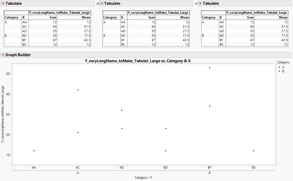

Now, I want that Graph Builder to fill all the horizontal space. I don't know the size of that space, so I don't want to specify it directly, I just want it to fill all the space whatever is available.
I tried using Set Auto Stretching (1,0) on rgb, but it didn't help much.

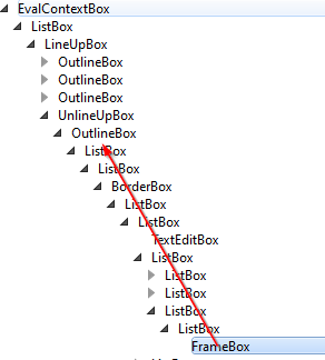

Experimentally, I found out, that if I go to properties and change Stretching for X from Neutral to Fill for EACH AND EVERY BOX from Frame Box all the way to Outline Box, like that:
then it looks like I want it to look:

Update: I guess I should be able to use XPath with ancestor-or-self (or in simpler variant just ancestor below), but I can't get it to work.
rgb << Xpath("//FrameBox/ancestor")

Ok, I tried to more things:
rgb << Fit To Window("On");
This one did not work.
rgb[FrameBox(1)] << Set Auto Stretching(1,0);
This one, where I apply Auto Stretching to FrameBox, not the whole report - did work.
The questions that I bumped into in the process still stands: What is the proper syntax for XPath Axes? Like, ancestor, child, ancestor-or-self, etc....

Re: How to stretch GB to fill all available space?
I think it works if you set Auto Stretching on the Frame Box after the report is cloned:
lb[FrameBox(1)] << Set Auto Stretching(1,0);
Stretching properties are usually cleared when boxes are cloned, because behaviors do not always translate when the layout changes.
