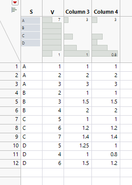

If the first voltage is always first you can just use with byVar Col Min() (Column3) and if it isn't then a bit more complicated formula should work (Column4)
Column3:
:V / Col Min(:V, :S)
Column4:
:V / :V[Col Min(Row(), :S)]
-Jarmo

Thanks for the feedback. The formula you shared works if the 1st data point is the minimum for the particular S. However if that is not the case, how would you approach the formula?

Did you try both of the formulas?
-Jarmo
Re: Need help with data normalization
Jarmo,
The Formula for Column4 is the one that works! Thanks a lot for your inputs
