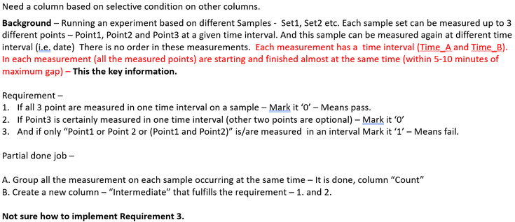

I am looking for % of fails in measurement procedure. My requirement and sample data is below.

Georg

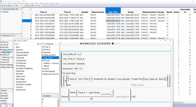

The most tricky part here is to define a proper grouping column (see Avg_Time and concatenated with Sample --> Group).
This is similar to your "count" concatenated with Sample.
If I would need to calculate the requirements, I would do it like shown in the table in Column "Result". Behind the scenes it tries to find in each row: all rows belonging to the same group, and shows the measurement Points in column "Measurement in Group".
Please see attached table for the details.
