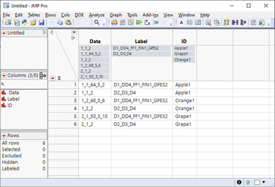

Input Data Table:
| Data|  Label | ID |
| 1_1_64_5_2   | D1_DD4_FF1_FIN1_GPES2   | Apple1   |
| 1_1_2  | D2_D3_D4   | Apple1   |
| 1_2_68_5_6   | D1_DD4_FF1_FIN1_GPES2   | Orange1   |
| 1_2_2  | D2_D3_D4   | Orange1   |
| 2_1_50_3_10   | D1_DD4_FF1_FIN1_GPES2   | Grape1  |
| 2_1_2  | D2_D3_D4   | Grape1  |

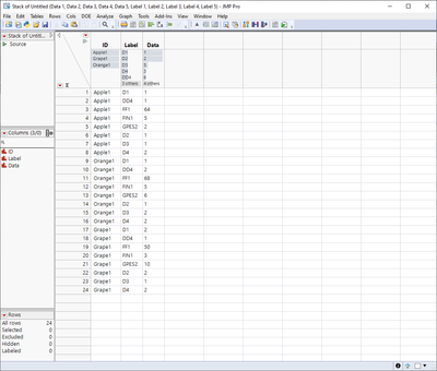

Output Format: (column sequence arrangement does not matter)
| ID|  Label| Data|
| Apple1  | D1   | 1   |
| Apple1  | DD4   | 1   |
| Apple1  | FF1   | 64 |
| Apple1  | FIN1  | 5   |
| Apple1  | GPES2  | 2   |
| Apple1  | D2| 1 |
| Apple1  | D3| 1   |
| Apple1  | D4   | 2   |
| Orange1| D1   | 1   |
| Orange1| DD4   | 2|
| Orange1| FF1   | 68|
| Orange1| FIN1  | 5   |
| Orange1| GPES2  | 6   |
| Orange1| D2| 1 |
| Orange1| D3| 2   |
| Orange1| D4   | 2   |
| Grape1  | D1   | 2   |
| Grape1  | DD4   | 1|
| Grape1  | FF1   | 50|
| Grape1  | FIN1  | 3   |
| Grape1  | GPES2  | 10   |
| Grape1  | D2| 2 |
| Grape1  | D3| 1   |
| Grape1  | D4   | 2   |

Can you provide example table? It is a bit difficult to understand the starting situation from just text.

I'm not sure what is the starting point, so I will assume you have a data table and not text file.

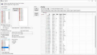

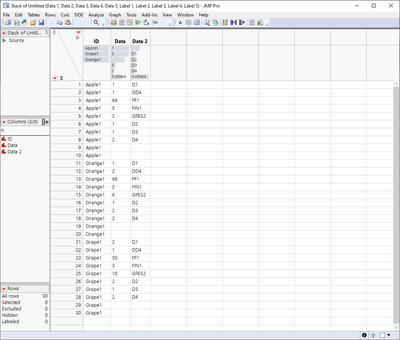

Next stack your data using multiple series stack
Delete extra columns, reorder and rename columns
Drop missing rows

Workflow is also attached (might require some cleanup) and cleaned script based on the workflow below (can be made much more robust depending on your needs):
View more...
Names Default To Here(1);
dt = Current Data Table();
dt << Text to Columns(columns(:" Data"n, :Label), Delimiters("_"));
dt << Delete Columns(:" Data"n, :Label);
dt_stacked = dt << Stack(
	columns(:Data 1, :Data 2, :Data 3, :Data 4, :Data 5, :Label 1, :Label 2, :Label 3, :Label 4, :Label 5),
	Number of Series(2),
	Contiguous,
	Output Table("Stacked result")
dt_stacked << Delete Columns(:Label, :Label 2);
Column(dt_stacked, "Data 2") << Set Name("Label");
dt_stacked << Move Selected Columns({:Label}, after(:ID));
dt_stacked << Select Where(:Label == "") << Delete Rows;
