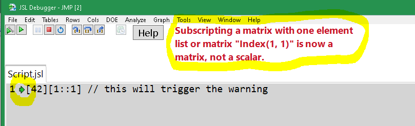

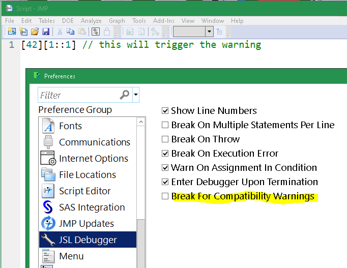

Re: My script won't run through debugger but will run without debugger
Preference dialogPreference dialog
The compatibility issue that usually trips this for me is illustrated above; at one time subscripting [42] with 1::1 (an array of elements from 1 to 1) would return 42. Now it returns [42]. The original thought was the scalar value was the common case, but being consistent for all 1::N is better because there is no special case for N==1.
This makes the debugger pause, making debugging painful. Change the preference! It probably works the way you expect it to now.This makes the debugger pause, making debugging painful. Change the preference! It probably works the way you expect it to now.
