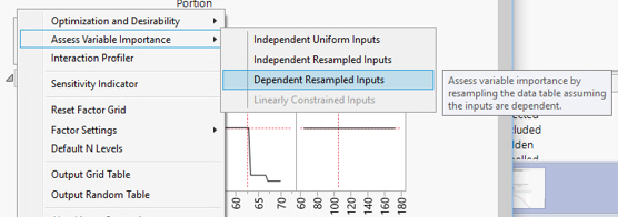

Re: Multivariate analysis for non-normal distribution (not transformable)?
...and, in addition to the modeling methods mentioned above, I want to call your attention to the Assess Variable Importance (a.k.a. the Sobol'izer)  pulldown in the Prediction Profiler.
Neural nets, in particular, are notorious for being "black boxes" that don't provide information about variable importance, and the Sobol'izer remedies that issue pretty righteously.  A reference is attached.
