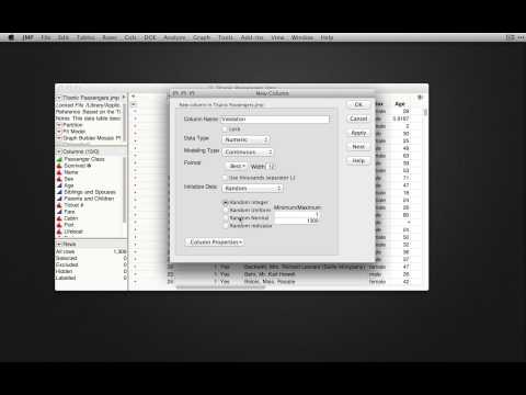

Stepwise is not available with non-continuous responses. Since you have Pro, there is a Validation column role in the Fit Model dialog.  You'll need to create a validation column first (shown here: https://www.youtube.com/watch?v=M5_mECc4NAg).  Unfortunately, I don't have a ready answer on the inverse-prediction stuff and I have to leave.  If no one else answers in the mean time, I'll try to come back to this.

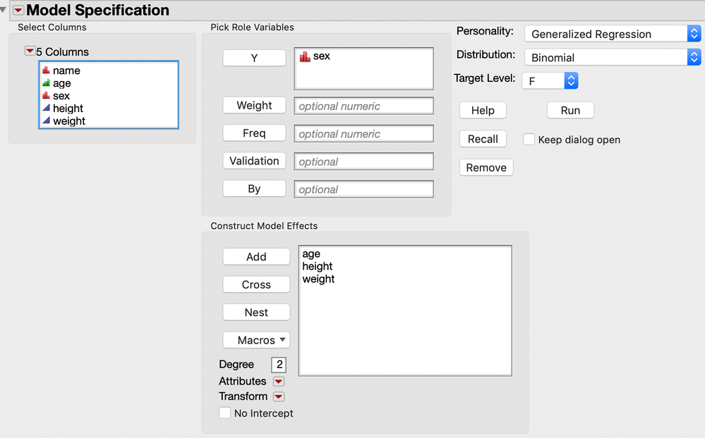

Follow this example.
  1. Open Big Class data table from Sample Data folder.
  3. Complete the launch dialog as shown below:

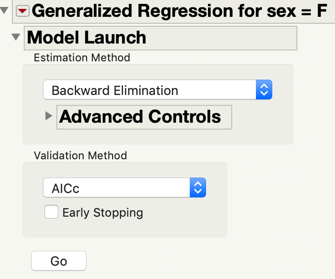

  4. Click Lasso (default method) and select stepwise method, such as Backward Elimination, and click Go.

Now I know what is the issue. When I put the nominal type of variable in Y field, I can not see the option “generalized regression” from Personality list. Type of Y has to be continuous numeric. In my case, Y value is either 0 or 1. I believe I should choose Binomial as Distribution.
