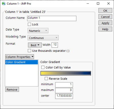

but in this case I would consider trying Color Gradient column property instead of coloring cells using << Color Cells

Thank you!
I overlooked such a convenient "Color Gradient" and "Standardized Attributes"!
