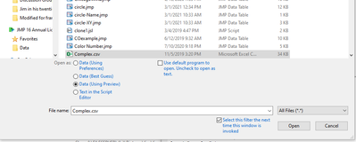

You might want to try another option.
  1. Click on Open
  2. Navigate to the folder where the csv file is
  3. Single click on the csv file you want to open
  4. A list of options will be displayed, select "Data (Using Preview)"txnelson_0-1624989098428.pngtxnelson_0-1624989098428.png
  5. Click Open
  6. Go through the input Wizard.  Start by unselecting "File contains column names on line:"
Jim
  1. Click on Open
  5. Click Open
Jim
