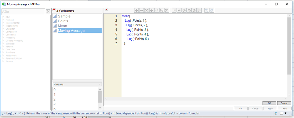

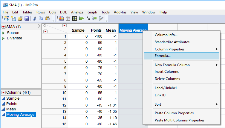

Regardless, here is how to use the formula that I provided you, create a new column in your data table and then right click on the column header and select "Formula"
As you can see in my example, I named the new column "Moving Average"
The next window that will open up, is the Formula Editor

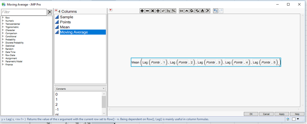

It allows you to point and click and create whatever formulas you want.  However, you can also double click in the blue outlined box that has the wording "no formula" and the editor will come up
As seen in the above window, I just typed in the formula, or it can be pasted into the window.  Then when you click on the "OK" button, you will see the graphical form of the formula
