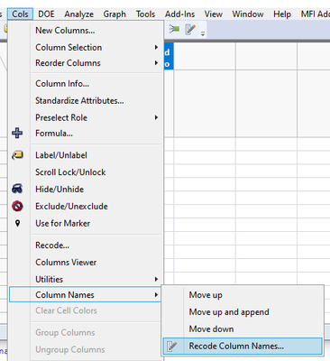

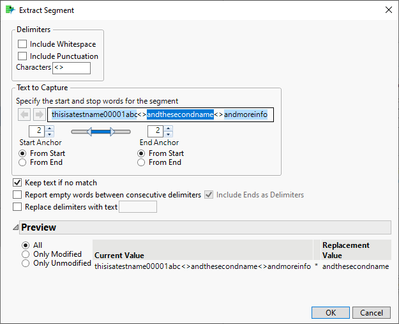

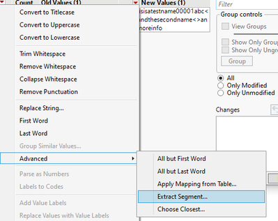

JMP does offer you with Recode Column Names
and Extract Segment could be something which works here
-Jarmo

Thanks. I tried the Recode already several time and the extract segment and that did not work either.
It seems because the number of characters before and after the <> symbol varies from one test name to another, I end up with some test names segmented and other not fro some reason.
