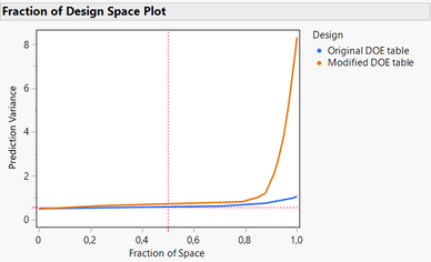

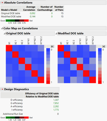

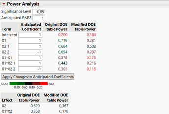

The sign change creates a big lack of optimality, significant reduction in chances of detecting the effects in the model (power analysis) and increase the prediction variance over the experimental space and correlations between factors :

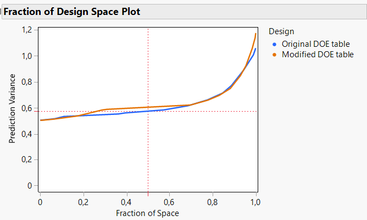

If the sign change at row 3 is only a mistake/typo (and is kept negative like in original design), the designs are very similar :
You can compare the designs by using the platform Compare Designs (jmp.com)
