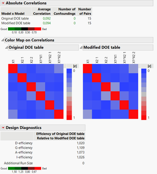

Little changes in factors' values (like 0,145 instead of 0,15) won't change a lot the performances of the design and results of the analysis, but I'm more concerned about the row 3, where there is a sign difference between the original and modified designs. Is it a typo, an experimental issue, ... ?
The sign change creates a big lack of optimality, significant reduction in chances of detecting the effects in the model (power analysis) and increase the prediction variance over the experimental space and correlations between factors :
Victor_G_0-1715683255220.pngVictor_G_0-1715683255220.pngVictor_G_1-1715683274684.pngVictor_G_1-1715683274684.pngVictor_G_2-1715683316750.pngVictor_G_2-1715683316750.png
If the sign change at row 3 is only a mistake/typo (and is kept negative like in original design), the designs are very similar :
Victor_G_3-1715683391836.pngVictor_G_3-1715683391836.pngVictor_G_4-1715683412526.pngVictor_G_4-1715683412526.png
You can compare the designs by using the platform Compare Designs (jmp.com)
Hope this will help you,

Hi @Victor_G , thank you for you explanation.
In Row 3 there was a typo, so I should be fine with adjusting the values.
