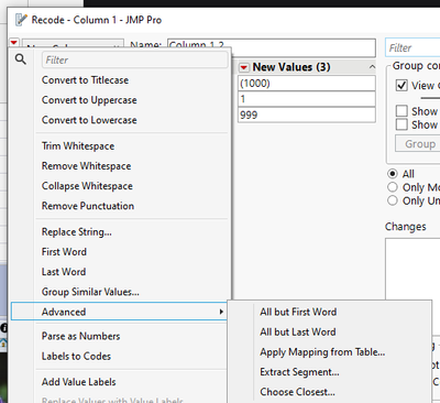

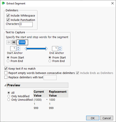

So you have extra () around those numbers? You could use Recode for example with Extract Segment

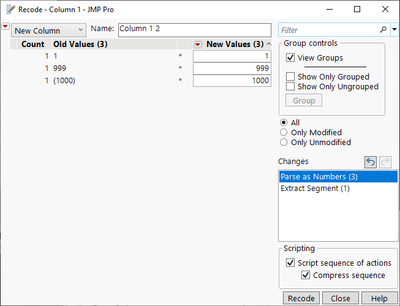

You can also add Parse as Numbers from Recode menu if you wish to but I think it won't convert to Continuous so you will still have to do that in a JMP table anyway.

Ah... JMPs auto-translator is removing the space. I would still go with Recode and then use Replace String instead of Extract Segment and use space as Search text
-Jarmo
