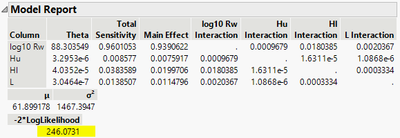

What you said about importance is mostly correct, but maybe incomplete. I circled out all the numbers that you should look at. They include all entries in Main Effect, and off-diagonal elements among interactions. Wind Direction is the most important single effect, but the interaction between Wind Speed and Wind Direction seems to have slightly bigger effect. In this case, even Wind Speed has comparably much smaller contribution, one should not rule it out from the model. In general, the numbers that I circled out should add up to one. All main effects and interactions contribute to the total prediction uncertainty.
It might be safe to say Separation Distance is not important in this example. And you might be able to see how it will affect prediction by removing it.

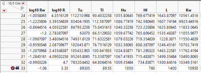

First I add a new row to the data table. The values are the means of individual columns, from the first column all the way through column "Kw". I hide and exclude this row, so it won't enter my analysis. I will use this row later to make my point.

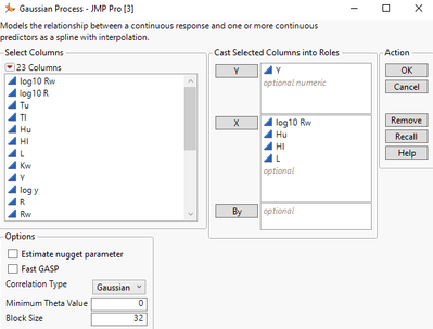

I fit a different model from the one on that example page. The model that I am going to fit will be more appropriate for this discussion. Here is how I configure the launch dialog:
Here is the report, and seems Hu is relatively unimportant.

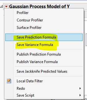

Before I rule out Hu, I save Prediction formula and Variance formula using the following two menu items.
And you should see two more columns in the data table. Notice all Y predictions (except the one for the row that I added) equal the corresponding Y, and all Y variances (except my added row) are zeros. This is what we should expect from Gaussian Process models. (The platform has an additional feature, for which case, the statement no longer holds. But that is beyond what we are discussing here.)
Notice, for the added row, the prediction and variance are for the new X values. The X values that I picked are just sample means. You may enter the values that you are interested in for prediction, and you may enter multiple rows if you are interested in predictions at multiple sets of X values. Just don't forget to hide and exclude your added rows, so they won't affect inference.

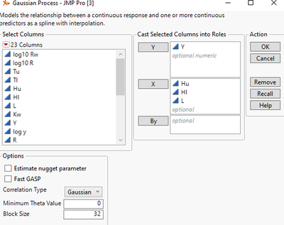

Now I remove Hu and fit a new model. Here is the dialog configuration.

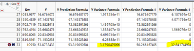

And I also save prediction and variance columns from this model. And here is the screenshot around the last row. And we can see variance is "much" larger.

Also I save Prediction and Variance formulas from this model, and here is the screenshot around the last row. And notice how much variance increases.

For Theta, I cannot think of anything specific about their interpretation. They are model parameters; see Models with Continuous Predictors It is those numbers that I circled out, which are calculated based upon the parameters, are more interesting and interpretable.
"Total Sensitivity" are the sum of entries under Main Effect and Interaction Effects on the corresponding row. One may interpret them from a "marginal" perspective, maybe? I am not sure about this. But I guess that it might be useful if one does not want to go into too deep into interactions, but meanwhile it is insufficient to just bring up the entries under Main Effect.
