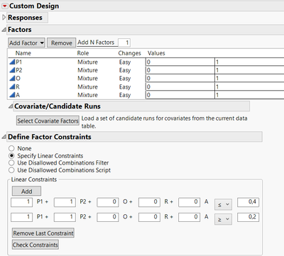

I was able to obtain a design with your specified constraints on P1 and P2 with the following linear constraints :
{1 * :P1 + 1 * :P2 <= 0.4, 1 * :P1 + 1 * :P2 >= 0.2}
Here is the screenshot of the platform :
Would these constraints work for your use case ?

It seems you have set-up your DoE correctly. Did you had any error messages ?
With the same configuration as yours, I can obtain a DoE table. If you have troubles, try using this script :
